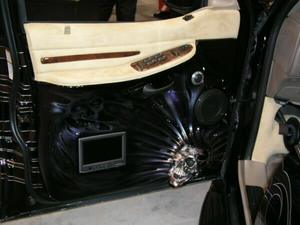

    Here is some fun f/g work i did for Audiobahn in a Navigator. Yes I made the skull in each front door. used precision board to sculpt the skulls and then made a quick set mold and then molded into door panel along with everything else u c there.

    I am diggin that skull, f'n cool KRU

    thanks for the props bras_33.
