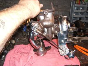

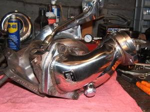

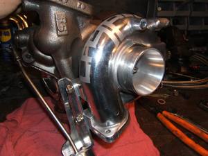

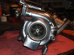

    here are some pics of the turbo kit we are working on here at Speed Corps. this is the one being custom made for me though :p
    Some rough specs on what the kit is gonna be:
    Evo 8 big 16 with an Evo 9 10.5 hotside ported and polished
    Megan O2 housing
    forge adjustable wastegate actuator
    Stainless Steel tubular manifold
    450cc injectors
    Evo BOV
    Evo intercooler & piping
    Custom downpipe
    Injen intake
    ECUflash for tuning
    Walbro 255 fuel pump
    AEM adjustable FPR w/guage
    Innovate LC-1 wideband
    i am planning on running 9psi, which should get me about 230hp with a good tune. I'm gonna be using stock internals for now, but eventually i will be getting forged pistons and rods, and building up the head.

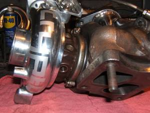

    very nice so your using a twinscroll hotside on a single scroll? would like to see if it makes any power difference.
  8. Kurisu
    Kurisu New Member
    Why not just pick up a regular 9 turbo? Not sure the 8 will perform as well as the 9. Looking forward to the dyno results :3
