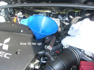

    Oil needed:
    5w-20. 4.2 quarts.

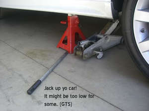

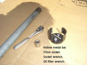

    Tools needed:
    Crap! I meant metal*
    Now, we start.

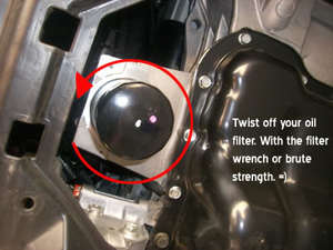

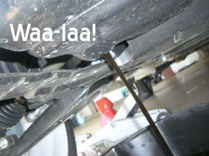

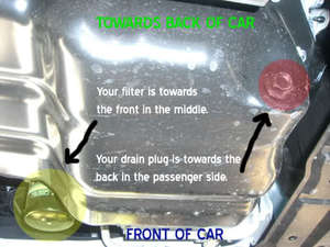

    Start with the drain first, then the oil filter. Just in case. Let them
    completely drain out.. 30 minutes or so.. Then twist in your new
    oil filter and put the drain plug back on. REMEMBER to oil up your
    new oil filter just a little bit before putting it back on.
    - Check for leaks!
    - Turn your engine and let it run for about 5 minutes.
    - Drive around the block and come back to check for leaks!
    Fin.

    the dealer ties the bolts and the filter tight and they put 10w30...i wanted to put the oil it says on the car so i did it myself...and i really recommend the hollow "medal"
    i actually did have a leak from the filter so i just gave it more elbow juice and its cool now
