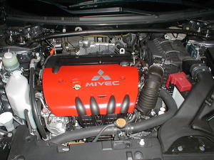

    Was bored today and had a can of red/orange (more red then orange) plastic spray paint. Saw others do thier engine covers and thought it looked sharp, so I did mine up aswell :D

  5. Wasper
    Thanks,
    I looked at dif pictures of the painted covers.. some people painted the whole thing, others left the black "down tubes" un-touched. I liked the way it made it look like there were tubes or something coming out of it, so I went in that direction.

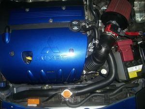

    i did mine electric blue.. to match the car, it looks sweet ill shows pics

  16. Wasper
    For me, I just used some household degreaser detergent and cleaned the surface very well. The plastic already has an "orange peel" surface to it, so as long as you use spray paint designed for plastics, there is no need to sand or anything.
    I used some of that blue pianters tape and tapped over the emblems and the "pipe" looking features, then took an small razor blade ande cut the extra tape off.
    Took me about 1 hour start to finish.
  17. Mada
    Mada Active Member
